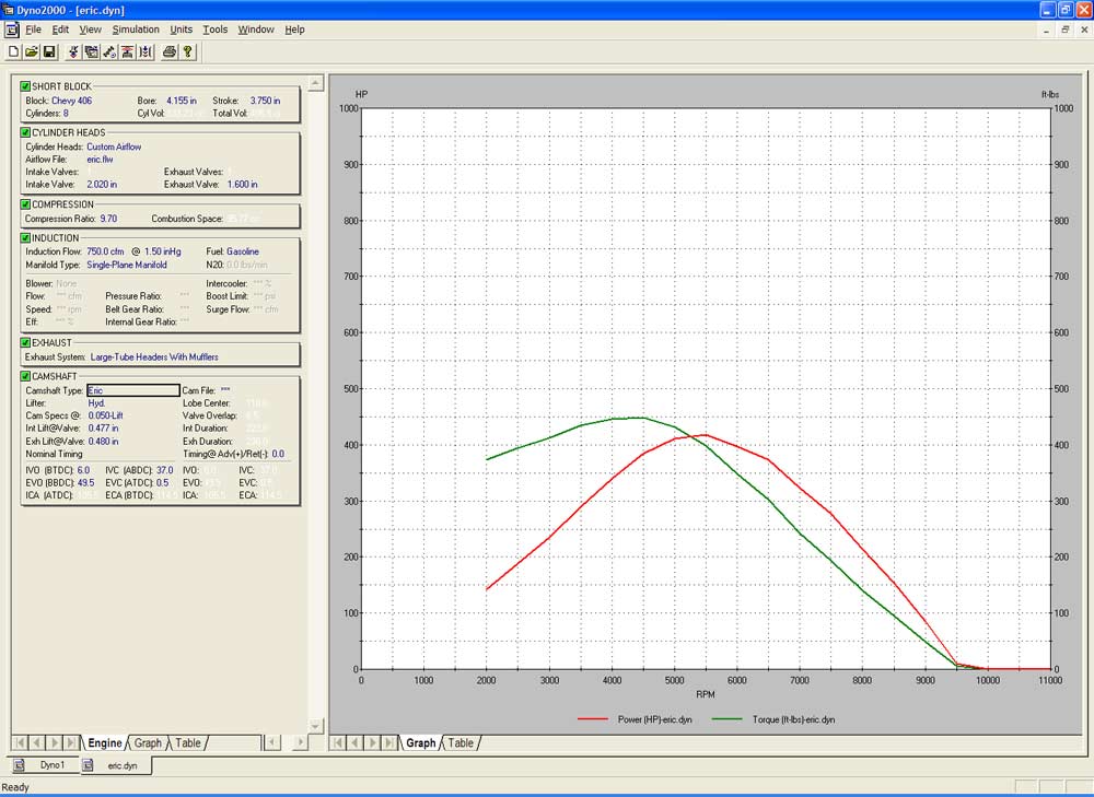

My first f body project is coming along good and I thought I would try and post a couple pictures of the progress.  I got the car for $700 with no motor and no trans, but the interior and body are in great shape and it came with 17x9.5 ZR1 wheels, eibach springs, and a adj. pan hard bar.  I have stripped and cleaned the engine bay and painted it with PPG DP90.  Then I installed the 406 I built that sports a forged bottom end, dart heads, roller rockers, comp cams extreme energy cam with 224in 230exh duration @.050, edelbrock performer RPM intake, a speed demon 750cfm carb, and is backed by a built 700R4.  I have also installed energy suspesion bushings, a bmr fab K-member, bmr fab boxed subframe connectors, and bmr fab tranny x-member.  Curently I am working on wiring up the ignition that is made up of a MSD crank trigger, a 6AL box, and a blaster ss coil.
