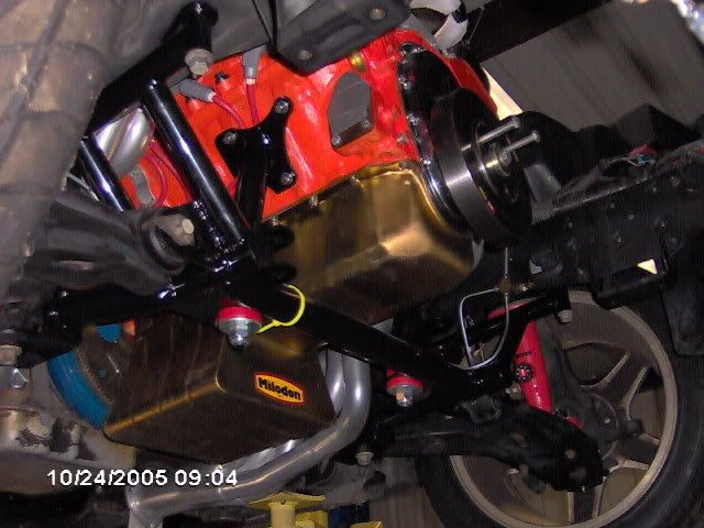

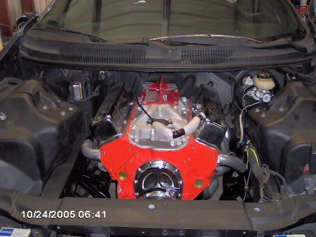

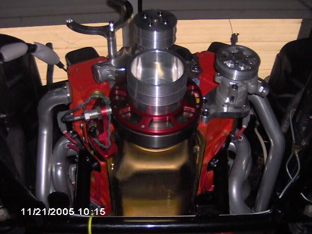

          If you asking if anyone here has put a gen 1 SBC in a 4th gen camaro, I have. As far as will you be in over your head, that depends on how mechanically inclined you are. Here are a few pictures of mine, as you can see by the date these are very old and lots have been done since, but it will give you an idea of what a gen 1 motor looks like in the car.
