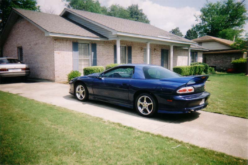

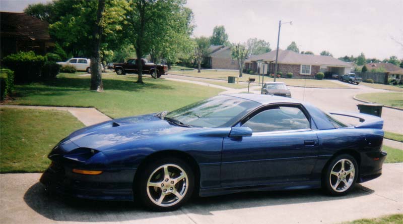

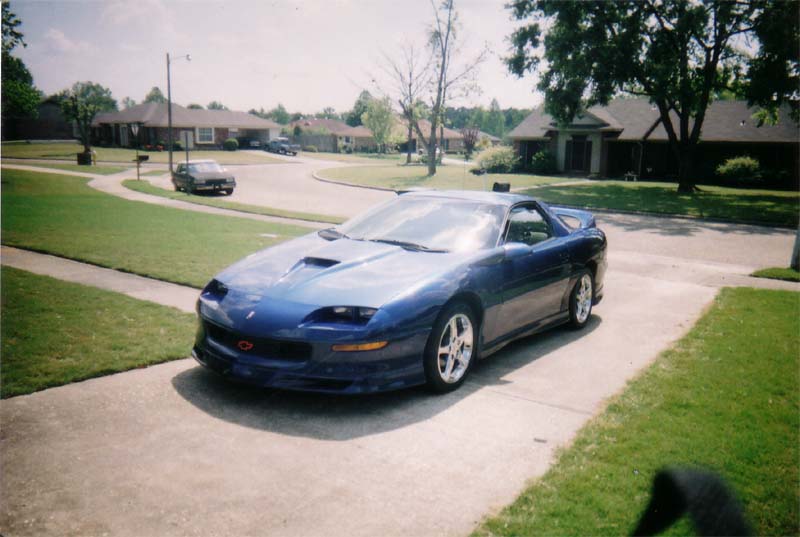

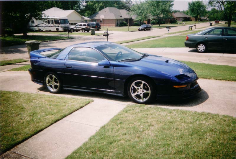

                      I got it back!
                      well my car finally was repaired. I loved how they left it great. Front Spoiler was replaced, painted front and rear bumper, side was painted too. Here some pictures.
