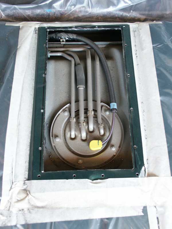

    ok, just got my walbro 255 fuel pump, ive seen several pages on how to cut a trap door and access the fuel pump... this is how i plan on doing this fuel pump, however a few things that are a needle in the back of my mind, i plan on using a dremel, but what is the clearance to the fuel lines, i mean if i make a wrong cut am i going to cut right into the fuel lines!? or do i have an inch or so of clearnace? this is the page im geting my info from....http://www.worldisround.com/articles/12533/, thanks!!
    -chris
    Man, im kinda "P-Oed"... i cant find the link i used. The lines are pretty close 1/4-1/2 inch away. But the metal is like 1/8 thick, so you really wont need to go that deep. The Lines are more to the right (if i remember correctly). Ill keep looking for the link i used. Just make sure ur careful with the sparks! lay some towels to make sure they dont get anywhere and watch the direction they are flying. Good Luck!

      You're going to be "OK" with the Dremel on the sides and the back. Its the front cut that you have to be careful with. Its very close, as indicated in the post above. If you use a Dremel, you need to hold the cutoff wheel so it barely makes it through the sheet metal. Mabe do 3 sides with the Dremel and consider snips for the front cut.
      If I was doing it, I would not cut sharp "corners".... they will concentrate any stress that the body has to carry. Try and round the corners off, rather than making them square.
        I am with Injuneer, i was thinking round corners myself. If i had to do mine that looks like the way to go. The process is very documented.

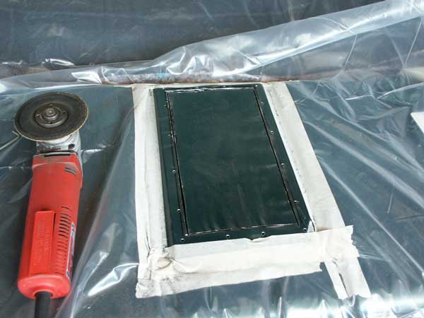

                      I did the trap door method about 8 months ago. At the time I did not think about doing round corners, but that would have been a nice touch. I used an angle grinder on my compressor and was just very careful as to how deep I went at the front portion. I also used the Racetronix kit which I believe uses the Walbro 255 pump, correct? Well, the car runs great and no complaints yet with its performance.

                          Just drill some holes where you want the corners to be - use a drill stop or collar set shallow to keep you from punching through. I cut the whole thing out using a 4" grinder with a cutoff blade - it took about 10 minutes from start to finish. Then I drilled and threaded a bunch of holes to hold the cover plate in, using my pre-drilled cover plate as a template. I can't imagine how long it would take to cut out with a dremel, although if you could get some of the larger & tougher fiber disks, then it wouldn't be as bad as if you try to use those fragile 1" disks that they give you in all the kits.
                          I think the hardest part of the whole install is getting the fuel lines undone and getting the pump/sender in & out of the tank.
                            Opening a trap door is not recommended. Always drop the tank and clean it (and the bucket) properly before installing a new pump. The trap-door install has caused many pre-mature pump failures due to contamination and is one of the contributing factors to Walbro canceling all warranty on HP pumps as of March '04!
                            If you are adamant in this approach do not use any method which will generate sparks. There have been a few fires because the vapor seal on some older cars was not 100%. Gas fumes may be sitting around the top of the tank. An air nibbler would be a much better idea. Snips or cutting wheels may damage the plastic fuel tubes and / or wires sitting on top of the tank.
