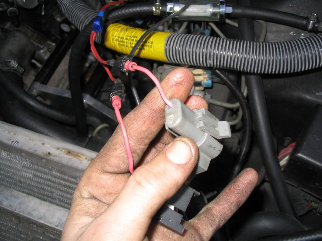

    got rid of my paxta fuel\msd igntion setup. however the coil plugs\connectors are in bad shape, on the pic below, one of the wires on the grey connector came off, so i need to get a new one and solder em back together. any place online sell these? i called a few dealerships they dont know theyre elbow from an oil filter... any help would greatly be appreciated!! thanks

    also another thing, on the stock lt1 94 coil, the grey and black connectors have 3 wires coming from them correct? which color wires are going to the grey connector and which color wire is going to the black connector? thanks alot!! it doesnt say the wiring colors in my haynes manual for these!! thanks!!

          Lol, the gray has a white/black and pink/black.
          The black has a pink (12v power) wire.
            Saw the connectors at a local auto parts store. Motormite makes them. Motormite site

                I think these are the ones...
                Item Number: 85120
                Description: Electrical - Sockets - Harnesses - 2 Wire
                Brand: MOTORMITE
                Description : 2-Wire GM Coil Repair (Black)
                Item Number: 85119
                Description : 2-Wire GM Coil Repair (Gray)

                  YES!! dude i dont know how you found those but you are the man! thanks!!!! but how do you order from them?

                        i just ordered a pair from rockauto.com, a motormite dealer, 14.50 each compared to the dealer which didnt even have any for 30.00 each.
