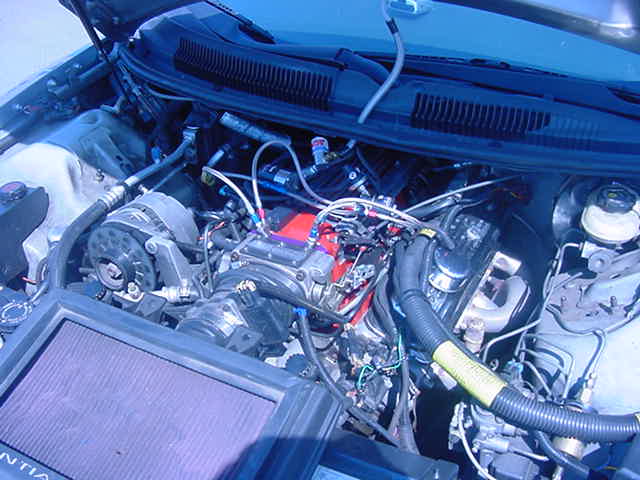

                          Here's the pics of the purge. The only problem I've had is that it blew the compression union off of the t connector at the track the other day. You can kinda see its not connected in the pic. I think I just didnt tighten it enough. Otherwise, works great.

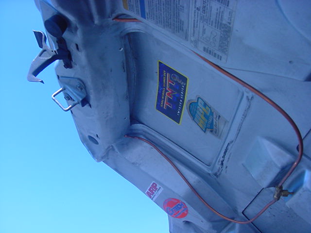

                            Here's another.

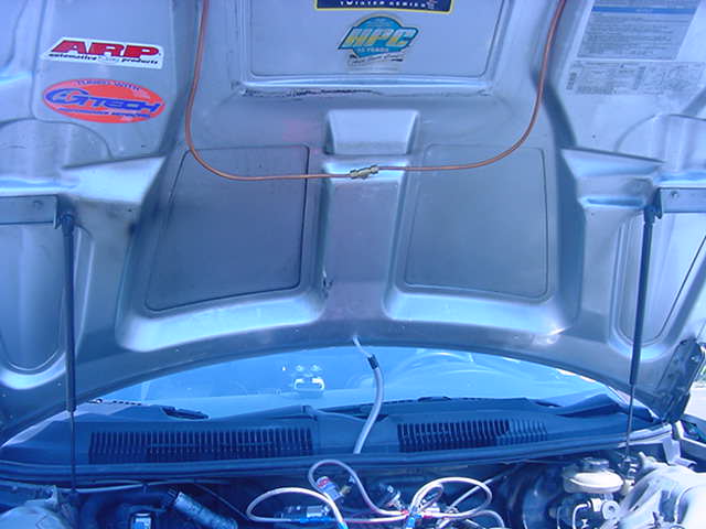

                              I dont know if im permitted to do this, but here's the third.
