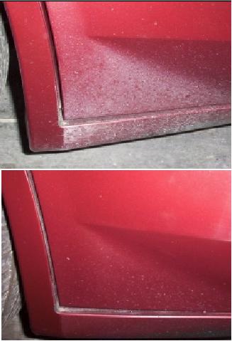

          You can do some pretty cool things with color sanding and buffing as shown in this repair-in-progress section of really bad road rash. I still need to shoot/fill and sand this again, but it give you an idea. However, spider webs usually can't be fixed. Actually, spider webs will appear in new paint if the old paint isn't completely removed from the affected area.
