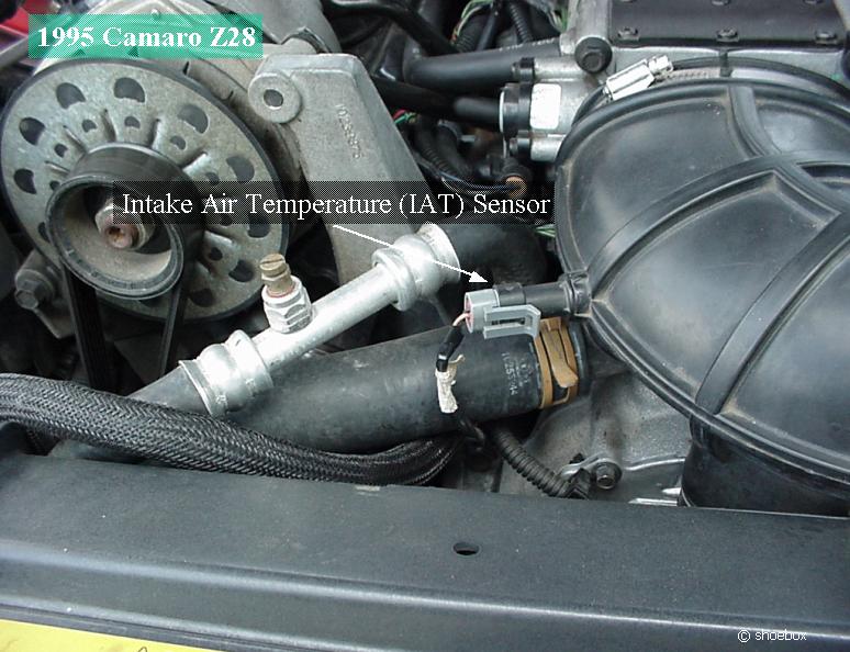

thanks what part will i need to keep i thought the iat was molded into the elbow?http://www.pontiacdriversclub.co.uk/ keeping it pontiac in the the uk. 93 formula a4 ZR1 rims

When you get your new elbow, you will notice where your IAT sensor goes, there is already a pre-drilled hole with a rubber ring fitting. What you do is you place that rubber fitting in the hole...the purpose of that is obviously to keep it more air tight. Then, remove that black plastic piece that your IAT sensor goes in to from your old rubber elbow. It's a bit snug, but easily can be worked out. Once it's out, just place it in the new elbow. Once again, you will have to work it in a tad, but an easy task. Then just clamp everything together, hook up your IAT, and your good to go.
I attached a picture of an IAT sensor courtesy of robs shoebox just so there is no confusion.
thanks as allways top jobhttp://www.pontiacdriversclub.co.uk/ keeping it pontiac in the the uk. 93 formula a4 ZR1 rims
