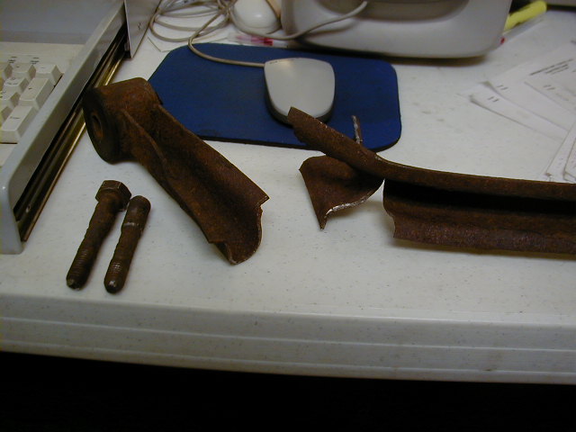

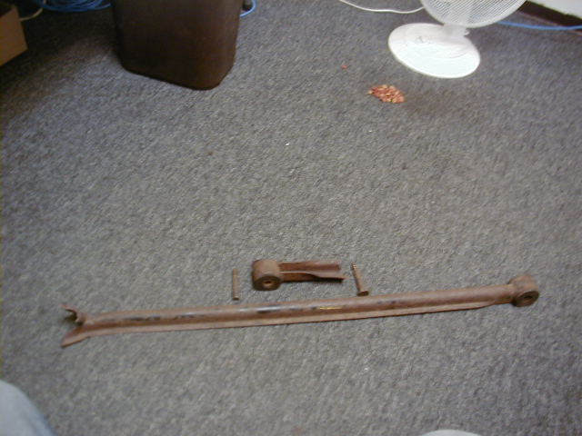

            It's self aligning unless you have an adjustable pan hard bar which I would highly recommend if you are auto crossing. You might break the stock one. Somebody on the board has broken one.
                You mean this one.....
                  Yea that's pretty convincing.
