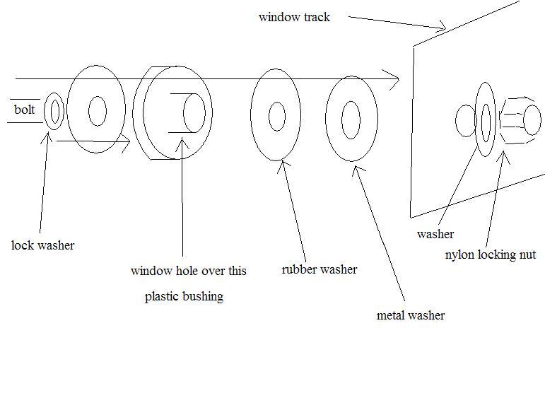

                          Well, I finally finished the window track install. Thanks, Tracy for the great info.
                          I couldn't wait for new fasteners, so I improvised. (Dealer said they had to special order them). I was able to reuse the black bushings, and bought some stuff from Orchard, which included rubber washers. Here's my crazy configuration. Hopefully this will hold up. Thank goodness I had several towels at the bottom of the door. I dropped the window once
                          I didn't have any time to take good pictures, so I had to draw it up. Forgive me for the absolutely horrible picture...very hard to draw with a laptop touchpad!
