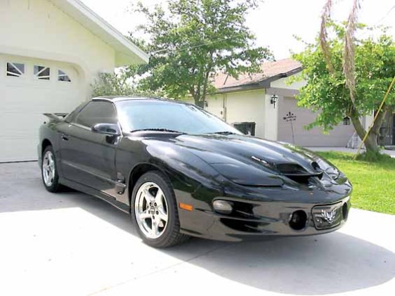

1999 Trans Am A4
Suncoast WS6 hood and Ram Air, Borla, UD pully, MAF, Hotchkis SFC's and STB, Eibach Sportlines, 18" Privat Fahrens, and Zaino of course
