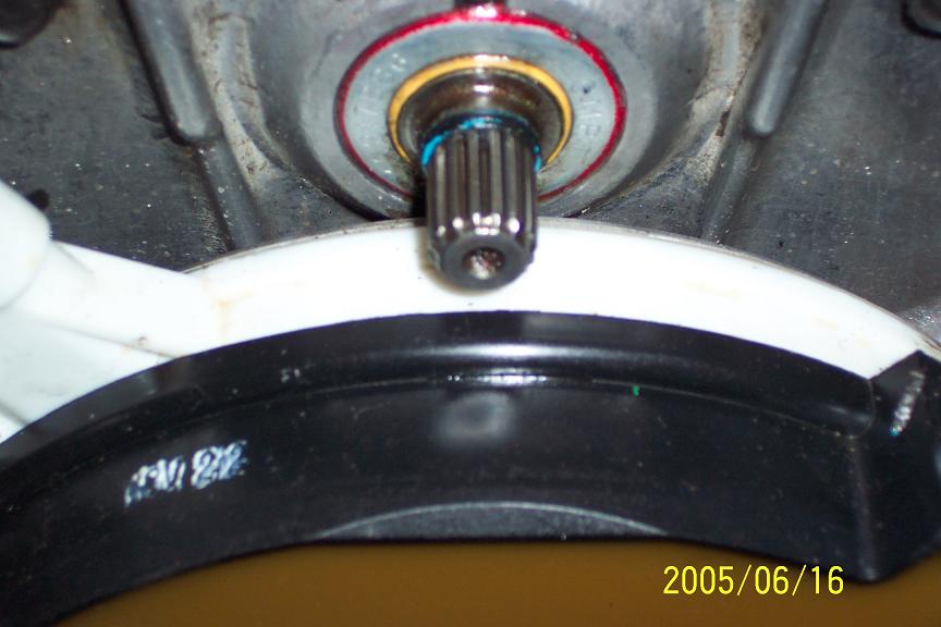

    Secondy, please check the attachment I have of my Water Pump seal in the Timing Cover. I recently installed it. Does it appear to be correct? What I mean is that the Yellow seal protruding away from the Timing Cover as opposed to be inverted like the seal delivered. As Far as I could see I could not avoid inverting the Yellow seal outward while trying to install it over the splined shaft. Make sense? Has anyone expirienced any leaks with it this way if it isn't correct?

    You probably need a new water pump seal that one looks like the rubber inside was damaged. I went through three of them before getting it right on the 4th try thanks to Joe. Screw 2 screws into the seal or use a slide hammer to get it out if you don't want to take your timing cover off again. When putting on the new seal cut a 1in X 3in piece of plastic from a 2L soda bottle and wrap it around the shaft. Make sure to lube the seal very well then slide the seal over the plastic place a deep well socket behind it and carefully and evenly tap it in with a hammer. Once its in use a pair of plyers to remove the plastic and it will be on without your seal getting ripped up by the splines. I hope this helps PM me if you need anymore help.

        Thanks guys for the info. I finally got it back together and so far everything appears to be fine. I'm keeping my fingers crossed just for good measure.
