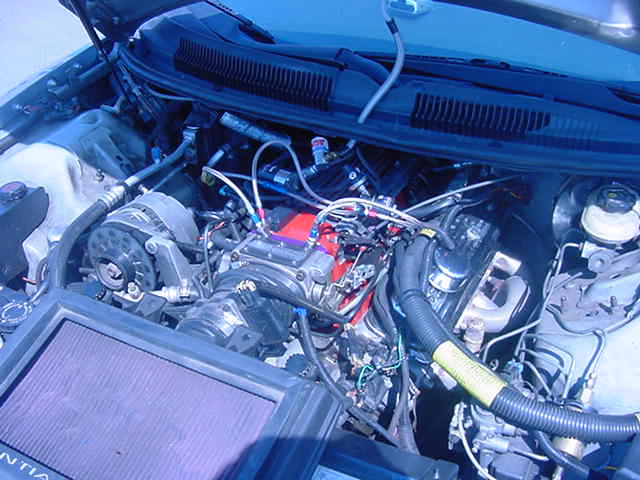

Do the v6 up. A supercharger isnt the end of the road, theres much more. Theres a whole cult following of v6 guys who run some serious numbers. You just have to research it. I agree with the rest. The swap is not worth it for the price of a used Z. Buy a Z28 (best option i.m.o.p.) or do up the V6 - it would be a sleeper.96 WS6 Formula: Ram Air, 383 Stroker, Ported LT4 Heads and Manifold, 1.6 Crane Rollers, 58MM T.B., AS&M Headers, Borla Exhaust, Meziere Elec. H2O Pump, Canton Deep Sump Oil Pan, 100 HP OF TNT N2O!! , T56 Conversion w/ Pro 5.0 shifter, SPEC Stage 3 Clutch, Hotchkiss Subframe Conn., Lakewood Adj. Panhard Bar, Spohn Adj. LCA's, BMR Adj. T.A., Custom 12 bolt w/ 3:73's, Moser Axles, Eaton Posi, Moser Girdle
