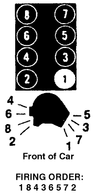

I am having a misfire on cylinder 2 but am not sure which side/position that cylinder is at. Anyone that can help me out???
Which cylinder????
Number 2 is under the alt. You can not see it you can not get to it you just know it is there.Make sure that the plug wire is not hitting the header pipe. That is what mine did. I put on a new wire an felt that it was not close to the pipe. P.S. take the alt off it is much easier. Good luck an have fun.
Blazer no 2 plug
