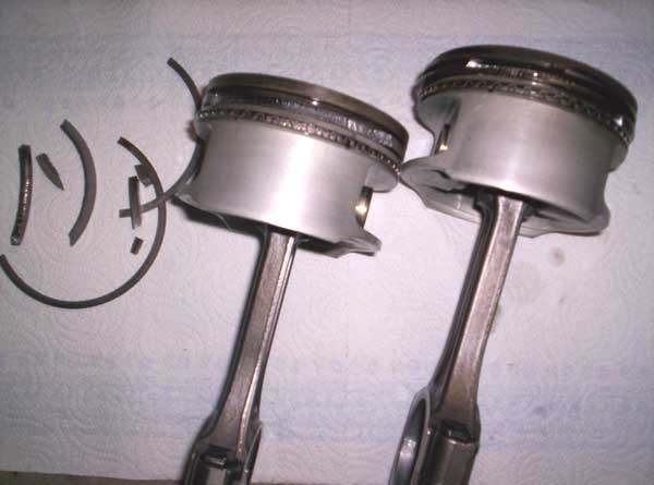

        Hey Mark, I am upgrading all my stuff and I will be having a lot of parts to sell all in excellent condition including Comp 212/224 114 blower cam, AFR double valve springs with titanium retainers (7k mi) or Comp 308 springs with steel retainers (3k mi) & Crane gold race 1.6 SA rockers (10k mi). Even though the springs are used, they are all deburred which takes several hours to do and have lots of life left in them. The cam is in the original box with the cam card and warranty card even. If you are interested in any of it, please e-mail me off list. Either way, you should at least do valve springs when you put on a blower. Don't forget that you won't get good performance even NA on old springs, and the positive blower pressure tries to keep the intakes from closing so the springs have that extra pressure to overcome.
        Also, here's what can happen to your stock pistons - my car still went 12.4 on it's lasst run with the head gasket blowing and 6 cylinders pumping...
