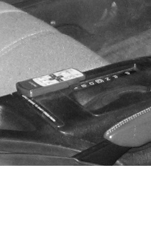

              i may not understand what you guys are talking about i run a f-body club in maine and we have about 10 cars , diff. years, and models and i have never seen one where you cant select 1st gear in my 94 Z you canselect from all 4 gears. what years and models can you NOT

                this is the pic
                  The 4th gen with 2.73 rear cars have no 1st gear selection [or #1 on the shift indicator] due to meeting a gov mandated noise requirement [ that could only be met by a 2nd gear roll by..]
