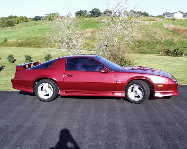

        I know how you feel by the way, couple years ago I had a 2.8 Firebird. Looked good, but always felt inferior on the street.
        But it wasn't a wagon/sedan/minivan/mustang, It was an F-Body damn-it , and I was proud.
        Now I'm styling a little better...
        1992 Z28
        Tpi 305
