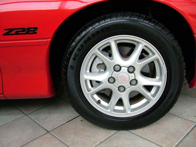

    What is the best way of cleaning the outside of the stock brake calipers on the 1998-2002 models? Originally they were kind of a grey color just like the one in the attached photo. But they get tarnished over time from salt, brake dust, and crap. Last season I wasn't able to get them looking that good.

            the reason i never really had the urge to paint the calipers is because they always looked so nice in their grey color, and had a nice appearance visible thru the wheel slots as compared with some cars that come with plain black calipers; I saw a new GMC Envoy the other day with the same type calipers as the camaro (at least it looked the same) and even that looked great. But I noticed that since moving up north to salty roads they are getting much more pitted-looking and stained. It wont be long till we'll be done with salt for this year and I'll need to pull the wheels again...
