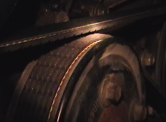

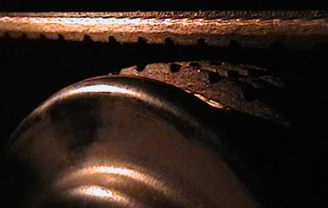

          Update on Serpentine Problem
          As I looked around the engine bay I saw a picture of how to bypass the A/C (from chevy themselves) so I ran with it. I found that you need to get a 87.5" belt and you almost need some vasoline to get it on. End product... as shown below a picture of the water pump pulley... it is entirely possible, but it only leaves you with about .25" clearance.
          sorry for the poor lighting I was in my garage and all i had was a flashlight.
