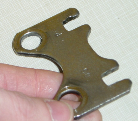

hey guys, after installing my comp. 7/16" 1.6 NSA roller rockers, 7.200" chromemoly pushrods, new 7/16" studs, and GM guideplates, I was unable to keep the rockers tight as they would keep loosening up after starting the car. I took the car into the shop and he noticed that the pushrods were actually wedging into the guideplate groove during one part of the stroke that they would get stuck and cuase everything to loosen up. It was so bad that it ended up bending 3 of the pushrods. What we ended up doing is taking the giudeplates back off and grinding a little bit of of them to make extra room.
I was just wondering if anyone else has had problems like this. I see on here that a lot of people are using that valvetrain package, and have never heard of problems like that. But, every car is different. I thought those GM guideplates were supposed to be the best fit. I thought maybe the pushrods were the wrong legnth, but checked with Lloyd Elliot what size to use with his LE2 head/cam package and he said to use the 7.2", so thats what I used. I also have a forged bottom end with 6" rods, but see how that would require using a different pushrod legnth. It runs fine now, just wanted to see what you guys think, or if you heard of this be4
