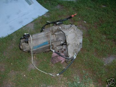

I am the proud owner of a 1994 z-28 camaro with a 4L60-E tranny. I have a few mods done to the car, more suspension parts than anything. The tranny is on its last leg, and when i replace it i want to put in a stronger tranny. I was recently introduced to the 4L65-E, the bionic tranny, its out of the Corvette Z06 and i think some other cars have it. Well anyways it mounts up to any car that originally had a 4L60-E tranny, my question is i found a 4L65-E tranny for sale thats used, but only has 8000 miles, its only description is 2001, pontiac,buick,olds,4L65E,transmission, only has 8000 miles, out of car hit in the rear. not sure what years will interchange, you will have to check! money back guarantee. Does anyone think this will matchup to my '94 z-28. I really hope it will.....

That is a front wheel drive tranny, dude. No way will that fit your Z.

All I was saying was the picture he posted was of a front drive trans. I should had been more specific.
Injuneer is right on the money. The 4T series trannies are front wheel and that is a picture of what looks like a 4T60E. If your looking to bolt in a 4L65E into your car, it will swap right in. However, the pic is definately NOT a 4L65E.

I looked at the pic, it is definetly a FWD. The guy must be trying to rip someone off. I am still looking for a 4L65 without paying GM 2,300 for one. Thank you everyone.....1994 Z-28 Camaro, 350LT1 A4, K&N Cold Air Intake, Edelbrock Long Tube Headers, Pro Flow Catalytic Convertor, BMR control arms & panhard rod, Eibach lowering springs, subframe connectors, Hotchkis strut tower brace.
