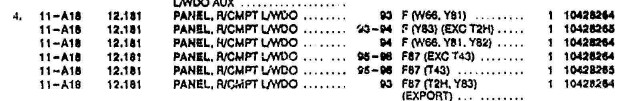

      Based on the parts manual you might have to have a different lid to accomodate a different wing. Check the option codes.
