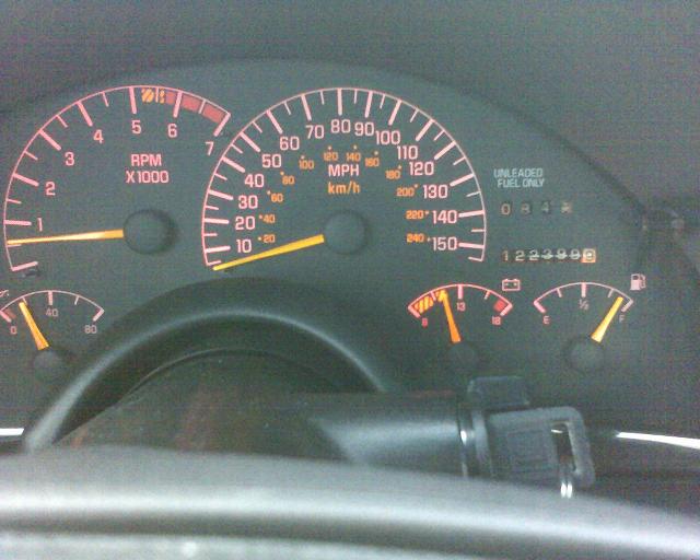

I'm having a problem where the car is losing voltage as it warms up. First thing in the morning, the voltage shows well over 13, maybe 13.5-14 on the dash. On the freeway, it stays up there, hanging around 13. Then, as soon as I encounter traffic, it drops a bit. Then, once the fans need to be kicked on, the voltage drops into the yellow. 550 idle in an auto makes it drop even further. Putting it into neutral, 650 rpm idle, helps a bit. I've been having this issue for years and have replaced many things electrical (ICM, coil, alternator) but it had 0 affect. A multimeter shows the battery around 12-12.5 off. So my question is, sine the dash reading is after the ignition switch, could the switch itself be where I'm losing some voltage? I attached a pic of a typical reading sitting in traffic, but it can get a lot worse than this. Thanks in advance.

Yes, the dash reads the voltage after it has gone through the ignition switch. The power connection there typically gets overheated and the tension of the connection can get weak. When it is warm out, I often see a whole volt or more less on the gauge than what is at the battery.Rob B 95Z A4 Tech Page (Part numbers / locations, how to's, schematics, DTC's...) Home Page - shbox.com
I did some testing, and when I saw the voltage in the yellow in the dash, I checked the battery. The battery itself read 13.67 volts. So I replaced the ignition switch and gained 1 volt at the dash under typical conditions. I kept the blue harness because it looked fine.
It still drops to the yellow in heavy traffic with lights and fans, but shoots up to ~12.5-13 when the RPMs go from 550 to 700. It didn't shoot up that quick before. But at least it's better. Maybe I'll try the fuel pump wiring next, since the switch powers that.94 Black T/A GT, Advanced Induction 355, 3200 stall, built 4L60E, Moser 9", Baer Brakes, Shooting for 11s...

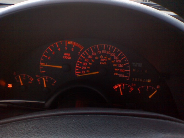

Another observation on the way to work is that the dash gauge shows yellow all the time now (except for the first few minutes at cold startup). It seems to dip 0.25 worse, at times, when driving on the freeway with higher revs. Idle seems to have the most volts (especially when the brake lights aren't on). It's only a difference of 0.25 to 0.50 volts, but I would have thought the alternator turning faster would mean more voltage. I guess not in this case.94 Black T/A GT, Advanced Induction 355, 3200 stall, built 4L60E, Moser 9", Baer Brakes, Shooting for 11s...
Driving home to work today was bad - volts were almost down to ~10.75 on the dash. Lights seemed to be a bit dim too. The alt output was well under 12.
However, the problem is fixed! It was the alternator. Luckily, I had a spare. Put it on, and idle now shows 14.2 volts. The dash showed well over 13 with lights and fans on. So I think this issue was unrelated to the original post. Originally, it showed low due to the ignition switch. But I already changed the switch, so this time it was the alternator.
