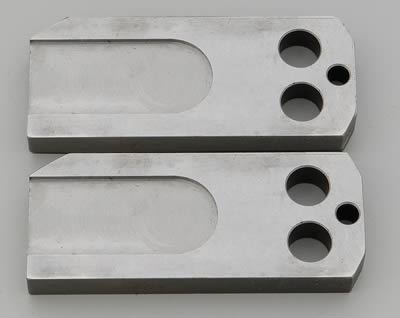

            You might need paddle kits for 4.10
            "Upgrade the gears in your rear differential.
            These SLP Performance Parts differential paddle kits make it possible to install 4.10 gears in any OEM or heavy-duty 7.5/7.625 in. Zexel Torsen differential without grinding the ring gear or center block. SLP strongly recommends the use of these kits for all such installations. "
            http://store.summitracing.com/partde...5&autoview=sku
