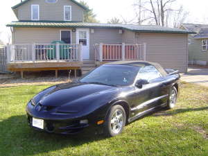

              [/IMG]Thanks again guys for all the help. I think I should have looked for the obvious first. First of all I had a typo on the first post. It is approx 20% off at 60mph not 10. Garbage in garbage out they say. With 3.23's and a tire that's too small that should put me right in the ballpark of 20% + /-. I will try the program for the 3.23's and I have a set of 255-17's for the car that are 26.5" tall. I was looking for a computer problem.... Previous guy changes gear...Takes program and tires with him = 20%. I'll keep ya posted.
                Very nice. Those look the WS6 rims. Are they 16's or 17's?

                  Thanks... standard chrome rims 16". They acually went with my old 95 t/a. That guy wanted them and I really want to go to a 17" rim. It will get polished 17" Torque Thrusts when the weather breaks. Right now it's away in the garage till the snow goes away.
