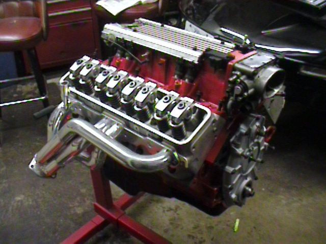

Thanks for the link. I did the tests and it passed on all 3. The only thing was my ICM has a differnt layout but the wire colors were the same. I just hate to change it out and have the same problems but these are known to go out and its the original so whats another $300. and some cut up knuckles right. Looks like you have the same car there steve. Mine is a black m6 but I have put about 3 grand into the engine and another $1200 into the rear end 12 bolt with 3.73`s. Next is a vortec supercharger if I dont go broke. Thanks again for the help and the opti is on order.
