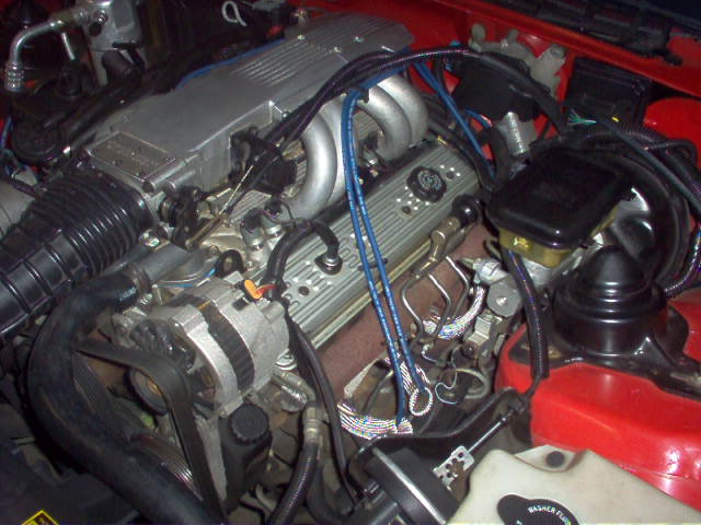

I have an 89 Formula 350 with about 94,000 miles on it. The car is in perfect shape and runs flawlesly without even a hint of smoke at star-up. It still tears up the streets and is very torquey. Is it safe to run nitrous at this stage and has anyone used it on their TPI set-up?
