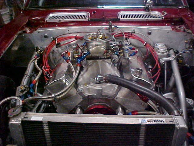

For reliability, cost and performance the Big Block is the best choice. Especially if you are trying to run 8s. I would also go bigger than 500". If you are building from scratch there is little additional cost to go to 600". If you are starting with a stock block this will not be possible however. I built a 632" from scratch for under 10K with new components, except the heads and intake, by doing all the work myself. These motors sell for 15-19K when built by engine builders but you must have the skills to do this. The car ran 6.0 in the 1/8th NA, thats about 9.4-9.5 in the 1/4. This car weighs about 3100 lbs too. Try and match that cost to a small block that can run those numbers NA and you will be spending about 20-25K more.
With some juice you will easily be in the 8s then with the proper chassis work.
Here is a pix of the 632, juice runs have been too much for the tires at this point but were working on it.
