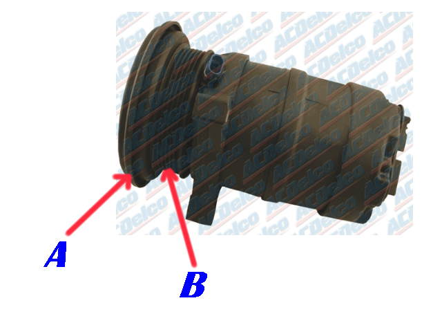

              Roger that, on the internals of the compressor, I understand that's why it would be hard to turn. But something you said may be the key to this problem, I just want to make sure you and I are talking about the same things. In the picture below (only one I could find quickly), I have the two items labeled "A" and "B".
              My understanding is that "a" is the clutch. Am I to understand from your description that this portion is always connected to the "guts" or internals of the compressor, and therefore would be hard to turn by hand? Do I have that right?
              Further, are you saying the portion marked "B" is supposed to be just a free-wheeling pulley that should turn quite easily by hand? Because it doesn't. It's very hard to turn. Is this just a pulley on bearings that has no connection to the internals of the compressor? If so, it must be the bearings that are trashed.
              Have I interpreted this correctly?

                Yep, A is the clutch which is always connected to the guts, and B is the free-spinning pulley, which also has a surface on it for the clutch to engage onto. If B is hard to turn, B is your problem.
                But.
                I've never pulled apart a compressor, so I don't know that you can replace just those bearings. If you want my opinion, I would replace the whole compressor, but you are talking about big bucks. The reason I say that is that once one part starts going out, it's just a matter of time on the rest of it. The clutch went out on my compressor, and I had originally planned on buying just the clutch, but the technician at my work got the car in the air and also noticed it was leaking oil out of the front, so I got a compressor instead.
