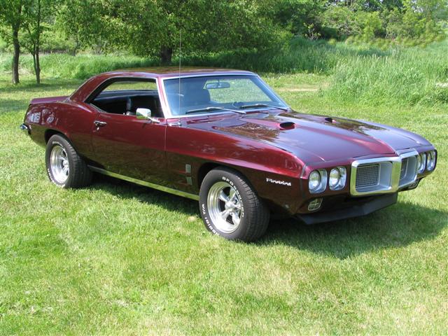

    I have a 1994 iron head LT1 in a 69 firebird. The following has been done to the car.
    ZZ4 cam
    ported and polished heads - Iron heads
    3 angle valve job
    port matched intake
    F car MAF sensor
    30 lb SVO injectors, had to, duty cycle was 100% at WOT
    CAI
    1.6 rr
    160* thermostat
    adjustable fuel pressure regulator
    hedman short tube d port headers
    Pypes 2 1/2" mandrel bent exhaust with X pipe Pro Flo mufflers
    LT4 knock module
    all free mods
    700R4 with all the toys inside
    3.73 12 bolt rear end
    Brian Herter initial tune, some tweaking since
    Runs real good, fun to drive and never been to the strip, I need DOT drag radials first, all it does is spin.
    Took it to the Woodward dream cruise and put it on the Dynojet Chassis dyno and put out 283 rwhp @ 5750 and 294 lb ft torque @4600. The torque numbers seem low for the ZZ4 cam, any ideas? I am putting on a 58mm Throttle body tonight and will redyno and tune soon at Hardcore Racing in Flint Michigan.
    something wrong ,seems very low

      For some reason to me that seems extremely low. For all that work I would guess it should be around 325-350rwhp.The 58mm TB is not going to make that much of a difference. Its max amount of power you get is like at 60-75% WOT if you are pushing less than like 500hp. The 52mm would have been a better choice, or even the stock one. Drag Radials are a Must no matter what. Best Bang for the buck at the DragStrip. Can knock off anywhere from .1-.4 If your going to run DR's on the street I recommend some Nitto DR's. They work Pretty well in wet surfaces, and real well in dry.
      P.S. Welcome to the Forum.
      P.S.S. You have pictures of this thing. Sounds Awesome!!
