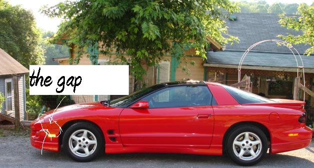

            I put a picture up of it
            THe arrows are where the gap is
              While this is a diagram of the Camaro, your Firebird should be similar in the way the bumper mounts. You may be able to do something in the area of #5.
                The problem everyone had with your description was the use of the term "front clip"...... that's not where your gap is, per the photo. Its between the front fender and the bumper cover. The "clip" is EVERYTHING in front of the cowl, including the fenders, hood and bumper cover.
