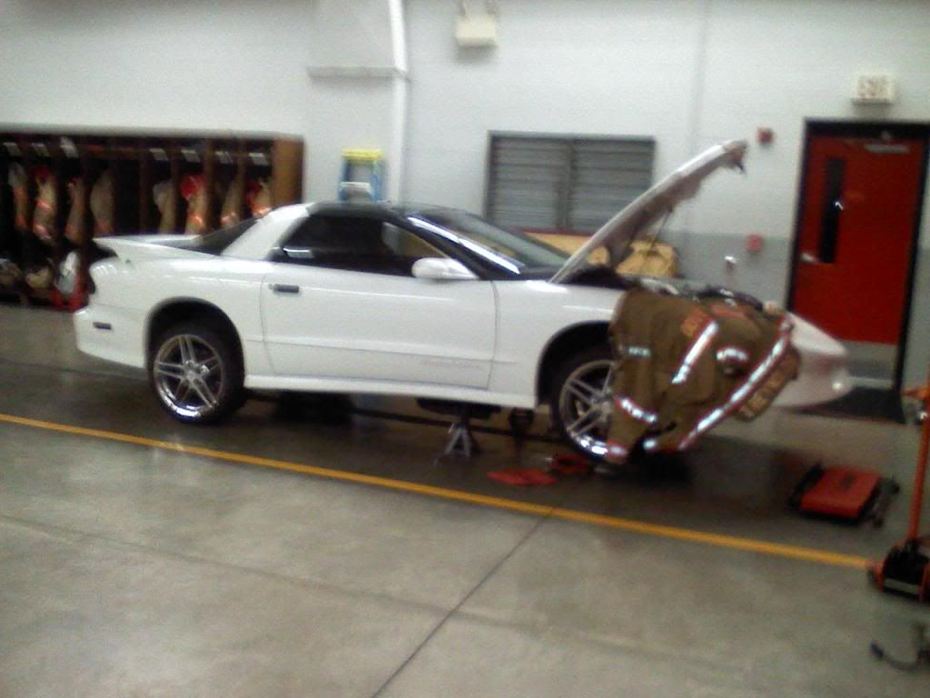

    Ok. finally got my jethot longtubes and am going to take it down to the firehouse and put in a bay up on jacks. Any how too's? Never done it before. got a basic idea but...... heard you have to remove the starter ect. Any place online have a step by step i can follow? It has shorties on there now and new plugs about 4k miles ago. I could pay someone to do it but then ill never learn. figure thats the best way to learn is to just do it. Is it better to jack up whole car or just the front? thanks.

            PITA!!!!!!!!!!!!!! 10hrs with two jackstand and a jack and 2 people. wow we actually didnt do to bad for never doing it before and we took a couple breaks. And the fact that for and hour and a half didnt realize that the drivers side was a 2 peice instead of one.(idiots!!!)

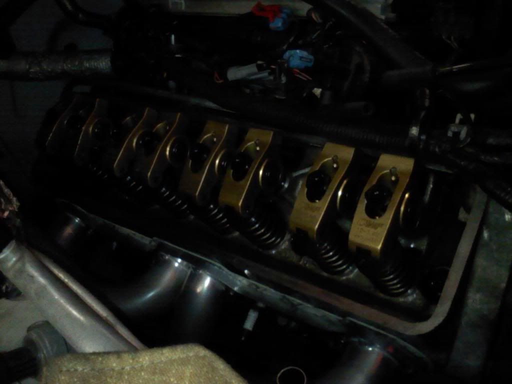

                cats? hmmmmm whats that? Actually im in need of a ypipe now. I couldnt get the bolt next to the block on the flange on the passenger side and it was on there pretty goo so i used a sawzaw and cut right before the cat. Im running open headers and i would not recomend it. Nascar comes to mind. LOUD. Some times in a particular spot in the revs it sounds good but 1500 rpm to 2k is so loud. Ill probably just get one custom made or find one with out the cat to go into the catback. After doin it and doing it wrong then right i probably could cut a couple hours of off it. ill post a couple pics.
