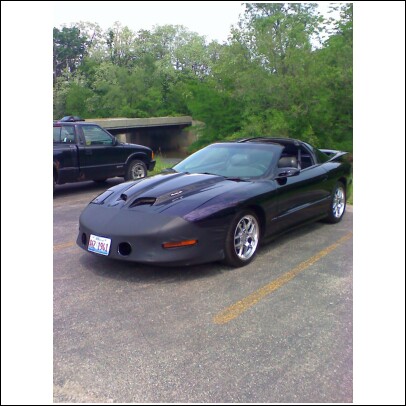

I have the same exact same car you have-lol. Im running a flow master thunder series. Its not super loud at idle, but opened up it is. I like the sound it makes. You would need two reducers so you can use your stock tail pipes. ill snap you a pic of my set up if needed.
now pic, and a before pic
