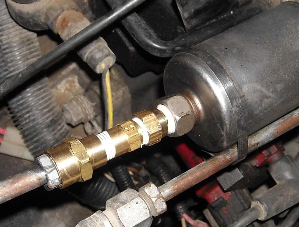

    Tests prove that the fuel pump check valve no longer holds pressure. Instead of dropping the tank or cutting a flap to replace the fuel pump (which still works OK), let just fix the no-pressure-at-startup problem.
    This is accomplished by installing an inline check valve (from mcmaster.com) along with a couple of Ace hardware flare adapter fittings between the fuel filter and the hard line. Similar to this:
    Cost under $20.
    BTW be sure to use teflon tape to prevent fuel leakage.

    is the check valve in the pump?
      Yes. The stock check valve is in the fuel pump assembly ($180), the fuel pump has a strainer on it ($11).
      To remove the fuel pump, the gas tank has to be removed ($100+ if a mechanic does it for you).
      Had one mechanic quote $660 to replace the fuel pump.
        What is the inside diameter, and rated flow capacity of the new check valve?
          Check McMaster. I got one w/ 1/4" NPT.
          They offer sizes up to 1/2" NPT. That should flow enough for anything street legal.
