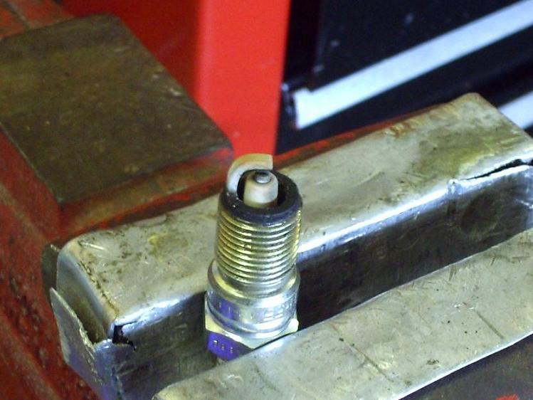

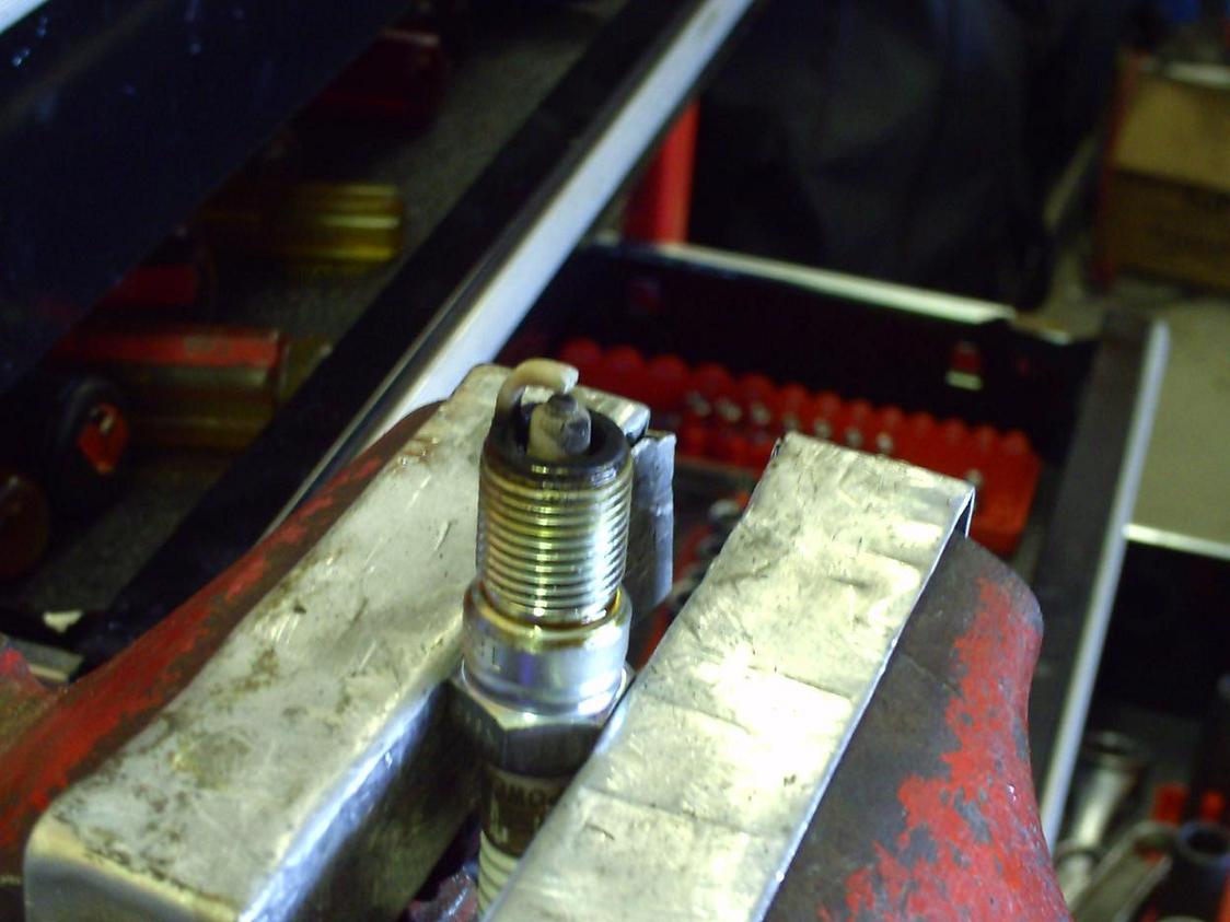

I pulled the plugs to see if maybe one was loose and saw a few things that might draw a flag. First, about 3 of them looked perfectly fine. 3 of them had orange on the ground electrode, and #8 was was completely white. Does white indicate a vacuum leak? The Haynes seems to indicate it, or too hot. One thing though was that the plugs were improperly gapped by the shop. They were between 0.057 to 0.060. I set them all to 0.050 when I put them back in.. They are TR-55s.
One more thing I was thinking of - the dyno shop had also readjusted the rockers and only applied thread locker to the rocker studs. The heads are so far ported, the stud holes are exposed to the intake ports. Is it possible that this white (or orange/white) plugs have a vacuum leak?
Attached are pics - the orange one is the least orange of the 3. The 2 were way more "orange" than this one. Thanks again.94 Black T/A GT, Advanced Induction 355, 3200 stall, built 4L60E, Moser 9", Baer Brakes, Shooting for 11s...
