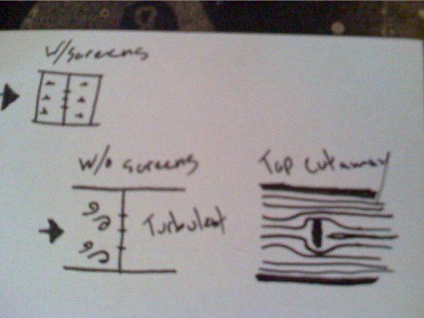

        "keep the CFM up but potential velocity down" doesn't really make sense if you think about it. Since the meter has a fixed cross-section area, the velocity has to go up proportional to the CFM.
        The objective of the screen is to provide a uniform velocity across the open area of the meter, so that the tiny portion of air hitting the thin film resistor is representative of the amount of air passing any other point on the cross-sectional area. That's why removing the screen ruins the calibration. The flow velocity distribution across the open area is no longer uniform. The uniform flow also helps reduce pressure loss through the sensor.
          right, but i'm thinking about the minute resistance from the support for the thermistors. Yes, the screen forces an even parallel flow laterally across the sensor, but i don't believe that removing the screen would increase the flow rating. I made a crude drawing to make sure we're talking about the same thing here. the first one is with screens, the bottom two are both without screens and generally speaking have much more turbulent flows. I'm also not really taking cavitation pockets into effect because I'm already thinking way too far into this.the bottom right would be a variating pressure pattern decreasing as you get closer to the outer diameter of the housing.
