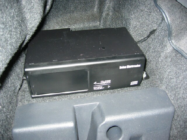

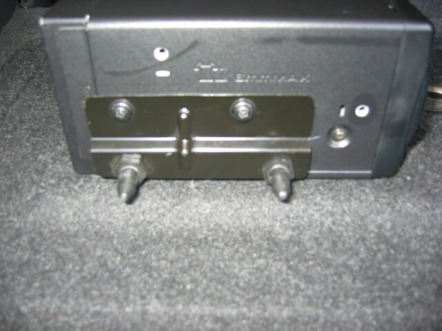

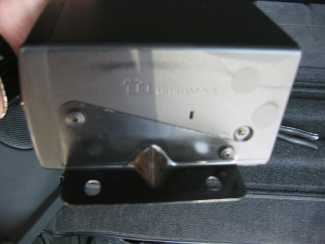

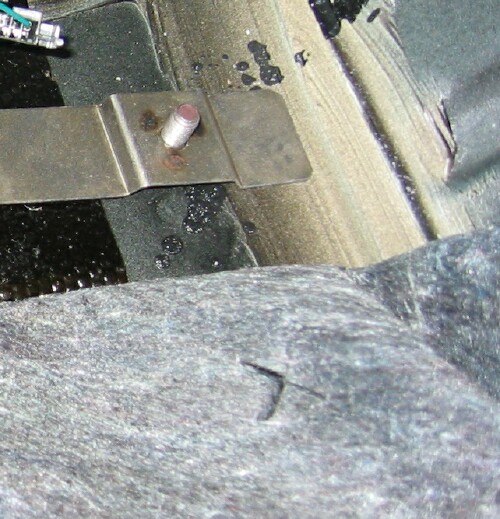

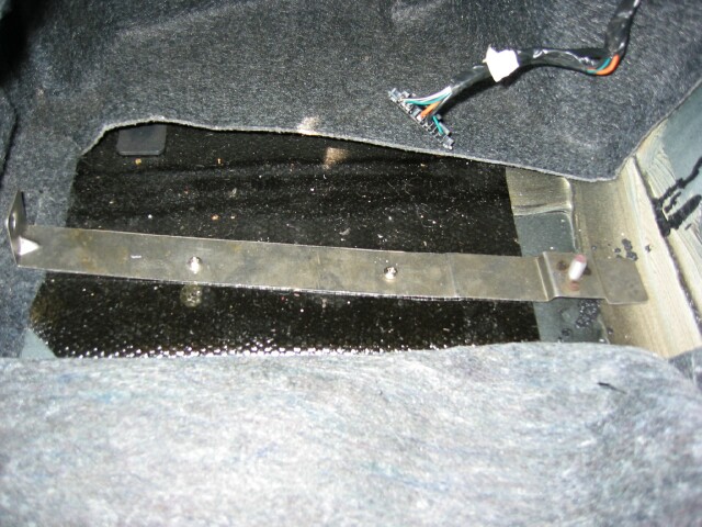

                  Not sure if the Camaro ones are the same as on the Trans Am. I screwed the bracket down with some sheet metal screws if I remember right. Just make sure to put it all together to find the best location to mount the bracket.
                  Here's some pictures from the Trans Am.
                    Thank you so much. The brackets that mount on the changer would fit different positions so it had me confused. This really clears things up. One last question. You mounted the lower bracket first then put on the trunk lining on top of it? Thanks again.

                      That's correct. I believe my liner had the one hole pre cut already.
