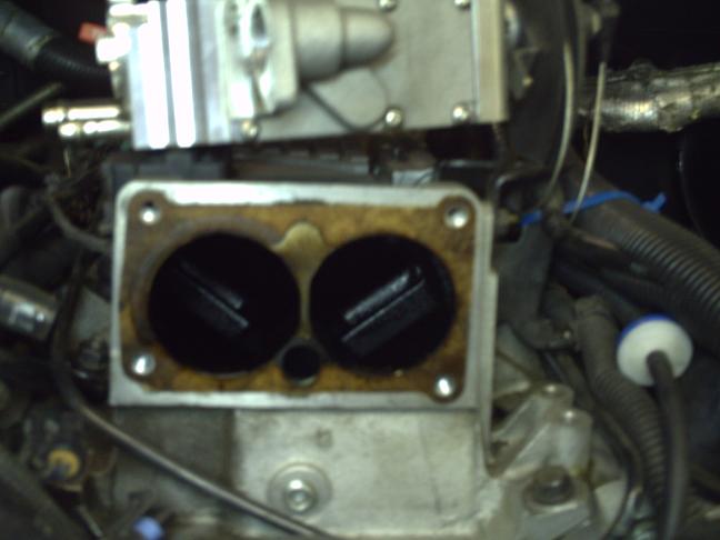

The motor has about 18k on it, since the build. I was told to use a higher weight oil, due to the better bearings, so I'm using Mobil 1 15w-50. It does have a couple very minor leaks (not sure where, but it appears to be minimal). I also notice that there is a fair amount of an oil coating inside the intake manifold. The stock LT1, prior to the build, didn't consume 1 drop of oil.

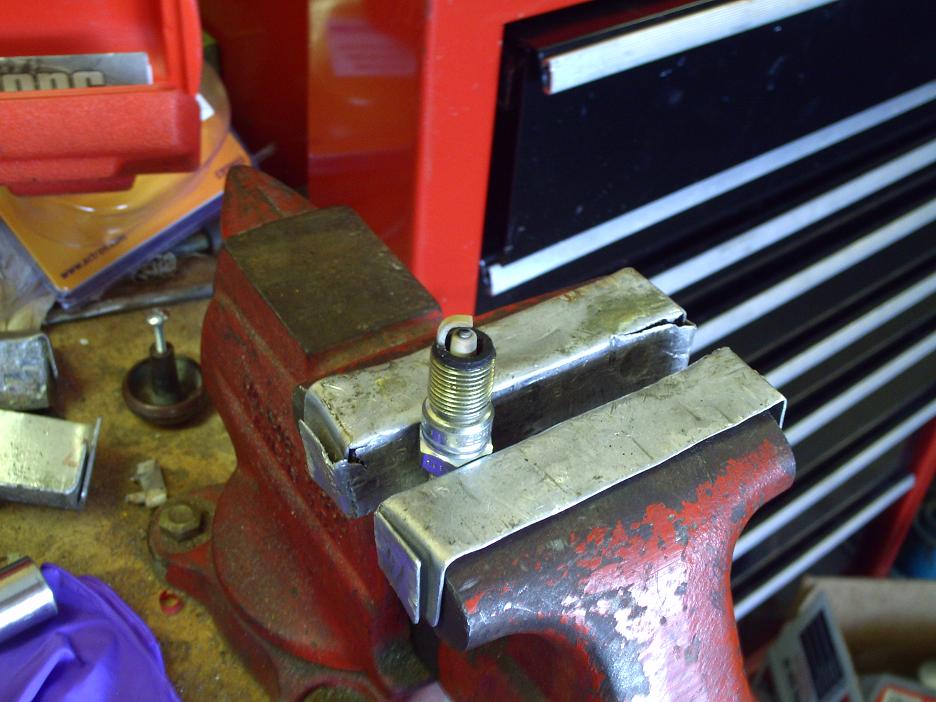

That's a lot. If you were burning it, you would see smoke...at the very least, you'd smell it. But, if your plugs are dry like you said, I'm starting to think you're leaking out somewhere.
