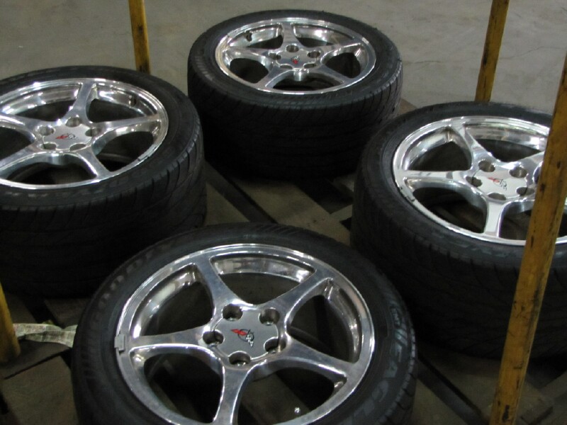

    I found a local sale of C5 Corvette wheels. They are 17's on the front and 18's in the back and following tires on it.
    Front 245/45/17
    Rear 275/40/18
    I believe that setup should work for my TA but just would like to double check before I try to negotiate. Attached is also a picture. Let me know what you think.
    Thanks.
    yep, just make sure to calibrate your comp for your speedo
    current
      To know if they will fit, you need to know the width and the offset. Some Corvette "replica" wheels sit too deep in the wheel wells, and require spacers. It sounds like you may have a set of 00 or 01-02 wheels (are they genuine Corvette wheels, or are they "replicas"?):
      17 x 8.5" 58mm (est. 6.90" backspace)
      18 x 9.5" 65mm (est. 7.75" backspace)
      Both those wheels will sit deep in the wheel wells, but should not rub on the inner fenders.
      And as noted, the rear tires do not match the stock F-Body diameter, which is either:
      235/55-16 = 26.1"
      245/50-16 = 25.7" (Z-rated tire option RPO "QLC")
      Im assuming since you show the "WS6" as a "mod" that it didn't come with the 17 x 9.0" WS6 wheels and 275/40-17 tires = 25.7".
      The sizes you mention:
      245/45-17 = 25.7"
      275/40-18 = 26.7"
      Speedo correction definitely required.

              Thanks for everybody's input and the link to the website. The guy is trying to sell them for a while now. Was hoping to get them for a good price but then with having to correct for the incorrect tire size in the back I think I'm better off to go with new all 17".
