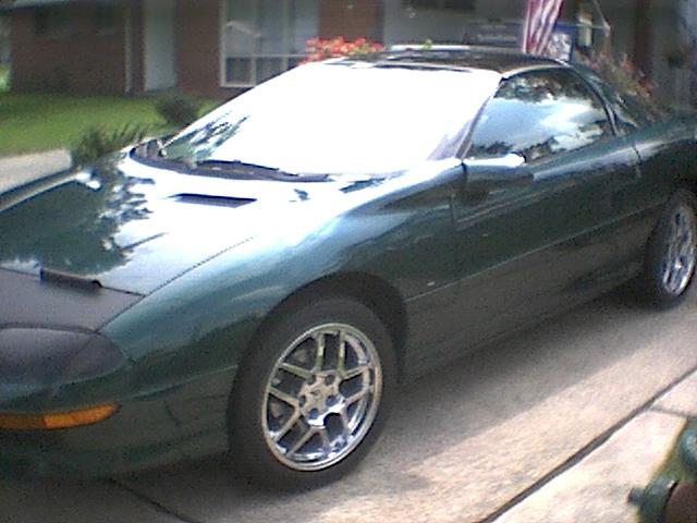

            Brian Diehl (ME) offers a set of 17 inch Z06 wheels also for a small fee of 800.00 dollars. Hit me back if interested check the pic
            ill take more pics if interested

              isnt the offset on real Z06 wheels different than our cars? if not ill be getting them from GM. if it is diffrent then i need to find a good place to powder coat them to the colors i want

                The data I have from the April 2002 issue of VETTE magazine shows the Z06 17x9.5" wheels have a 54mm offset, for both OEM and repro versions. The stock 17x9" SS/WS6 wheels are 55mm offset.
                If you do the math, that means the Z06 wheels will stick out about 1/4" further than the SS/WS6 wheels, and will have about 1/4" more backspace than the SS/WS6 wheels. They will fit perfectly. I've run 17x9.5" wheels with offsets ranging from 49mm to 56mm with no problems.
