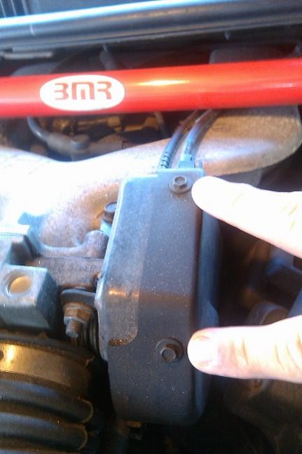

    Upon opening the hood, find the two 7mm screwing holding on the cover over the throttle cables....then remove them.

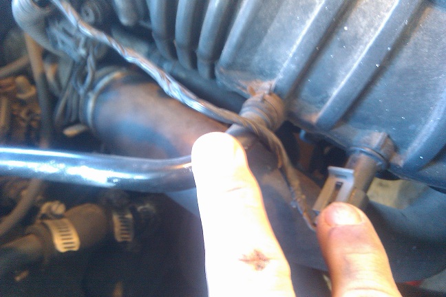

    After this, you'll need to unscrew the metal band on the intake boot, remove the plastic clamp on same boot, remove the pcv tube and unplug the sensor from the boot....remove boot and lay to the side.

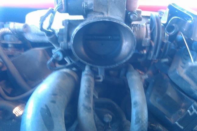

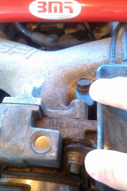

    Now, you'll need to remove two 13mm bolts holding the throttle body to the intake. Facing the throttle body, one bolt is about the 1 oclock position and the other is about 8 oclock position...remove the bolts and lay the throttle body down in front of the water pump out of the way.

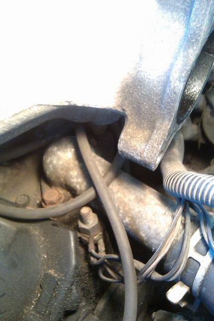

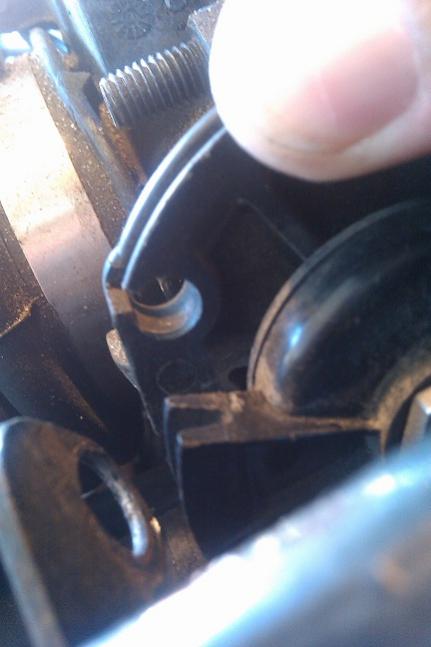

    At this point, the thermostat housing is exposed well enough that you can see it clearly and can get to it for the most part. To remove the passenger side bolt, use the short 13mm socket, the swivel, the extension and the rachet. To remove the driver side bolt, you'll need to use the box end of the 13mm wrench. This will take a few minutes to get out, so be patient.

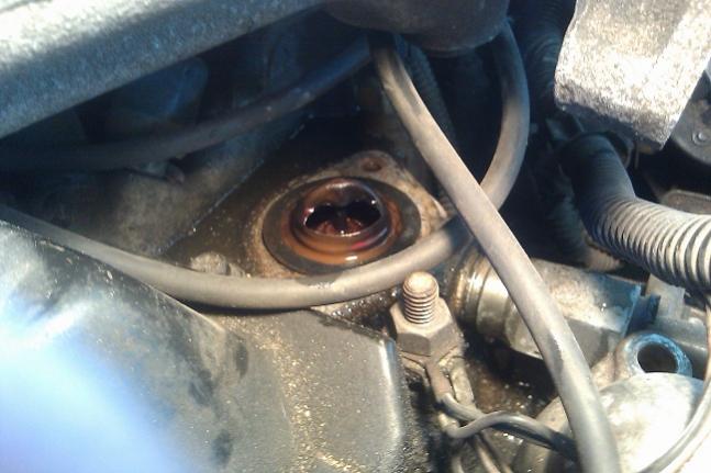

    Once you get the housing out and pulled out of the way, you'll see the thermostat...if you're lucky it'll be turned just enough to where you can use the screwdriver to pry it out.

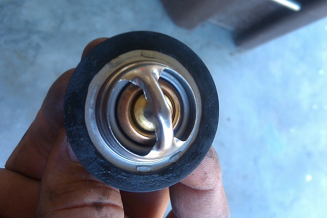

    Be careful not to tear the gasket when removing the thermostat and youll be able to reuse it. The gasket is rubber, has a groove in it and slips around the edge of the new thermostat.
