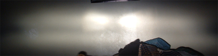

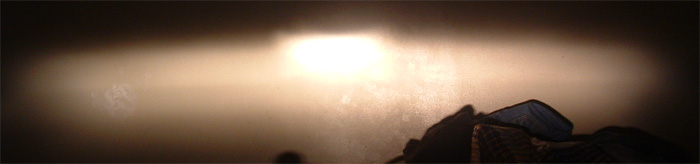

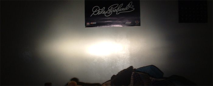

    Well, if you look at the top and bottom reflectors of the autooptiks housing, ones much shinier than the other. I placed the more reflective side facing up, which is how the OEM lights were installed. I took the lights out to take some comparison pics. I was able to pry out the old bulb from the housing of the OEM units, so I tried placing the new bulbs in there for some comparison. The new lights need to sit a little deeper into the OEM housing to match the beam pattern of the OEM lights. Here are the pics.......
    This is the OEM Low Beam.....
      This ones of the Xenon lamps in the OEM Housing. Putting the bulb deeper in the housing will bring together those two bright spots in the middle, but cant be done unless you shave off part of the neck of the housing or bulb base (Will Probably Try this Tommorow).....
        Finally, this is the pic of the Autooptiks Housing and the same xenon Bulb as the previous pic. Note how the beam is spread out vertically instead of horizontaly....
