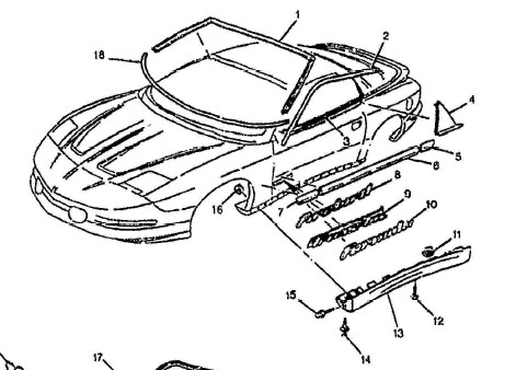

    I'm trying to remove the passenger side molding below the door. I found that it is cracked so I was in the process of removing it to see whether I can repair it or I need a new one.
    I figured out all the fasteners that need to be removed except one type. They hold the front part of the molding underneath to the front fender. There's 2 of them # 14 on the attached sketch. A big washer and a small head with two small flats on it. It almost looks like you need a special tool.
    Question is what do you need to do to loosen them up?

    I think what you are talking about is one of those plastic rivets. Get a small screw driver (flat tip) and pry up the center. Once you pry up the center pin the whole thing comes out big washer and all.

      According to the part # it should be one of these allthough it looks different than what I have. I guess I have to try again.
        Yep
        My guess is try again. That picture is what I was talking about, so if that's what is on your car just give it another shot.
