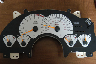

    Got my package from Ryan at Macewen Motorsports today, and all I can say is wow. I did not believe that these were this easy to do. It looks great and his quality is excellant. He also includes with some of the kits a new bezel from the later T/A's that is modified to fit the earlier cars. It seperates the gauges and really makes the dash look very slick. I will get pics of it installed when I take it out next. Too dark in the garage to shoot good pics.

        Not that bad. The instructions were well written and the hardest part was getting the gauge assembly out from behind the steering column. It says that you can remove the tilt lever to help this...., well my tilt lever was installed with about 900 lb/ft of torque, so it wasn't coming off. Took maybe an hour and a half, and I was being really anal about getting everything lined up just perfect. The overlays are designed to be put on w/o taking the needles off, which is the #1 reason I chose Macewen. After doing this, and seeing the results, I would recommend these to anybody.

                  Problem with the Pontiacs is that the red actually comes from the gauge face, not the lights. So that means that in order to change the color, you have to eliminate the factory lighting all together. That can be a tricky deal. Camaro owners can change their color with different bulbs in the gauge cluster, and Macewen sells high intensity xenon bulbs that look great. For us Pontiac guys, however, red is the way!!! I've always loved the red color at night.

                          Yes they light up red at night. They are pass through for the light. The red comes from the stock gauge face, not the bulbs so you are stuck with red for teh most part.
