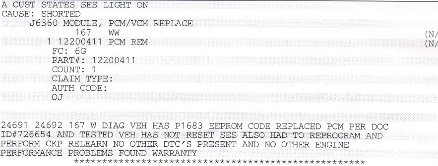

        well a couple days after i posted this, the dealer guys told me it was just a bad ECM and replaced it. i was like whatever i KNOW that wasn't the problem cause of countless people i know whom a dealer said they replaced the ECM due to a SES light. my brother in his 98 Acura Integra being one of those. he payed $600 for them to replace it, only to go out to the car in the DEALER PARKING LOT to turn on his car and have the light come right back on. he got his money back after they found the loose wiring for the VTEC solenoid.
        but anyways, all i cared abut was the light was off and it was on record as being a problem, even though it looks like same ECM is on there.. well today i was driving,, and the light came back on again.. took it up to work and got the EXACT same trouble code... so im gonna take it to a DIFFERENT" dealership, ask them if the ECM has been replaced, and MAKE SURE the work has been done, and that they didn't just reset the light..
        what can i do if i find out the ECM or whatever the service order said was replaced really wasnt.. (the service tech told me the ECM was replaced, but i can't really tell from the service order.)
