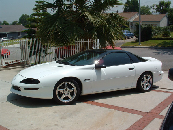

          here are some pics I just took for you.
          Check out the Zainy Zaino finish! (5 coats so far)
            Thanks, Those look real nice. Did you feel any improvment in traction over the 245s since traction is definately a concern for me. BTW I need Zaino, your Z looks so much more shiney than mine Later
