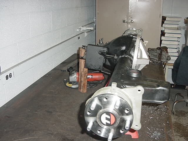

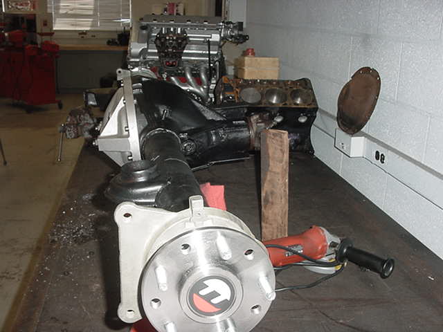

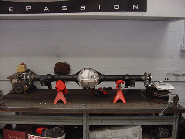

    Just a for some final suspension pieces to arrive in the mail and hopefully I will put it in this weekend. I spent all day on saturday setting the gears up. This one was a PITA. I put it together and took it apart 5 times in order to get the backlash and gear tracking right. I think its gonna work out well. Just for the record though........its not worth the 500 or 600 hundred dollar savings over Moser, unless you just like to do it for the challenge.
    oh......for those that dont know, these are pics of the 12 bolt rear that I built.
    heres another pic....
      one more.....

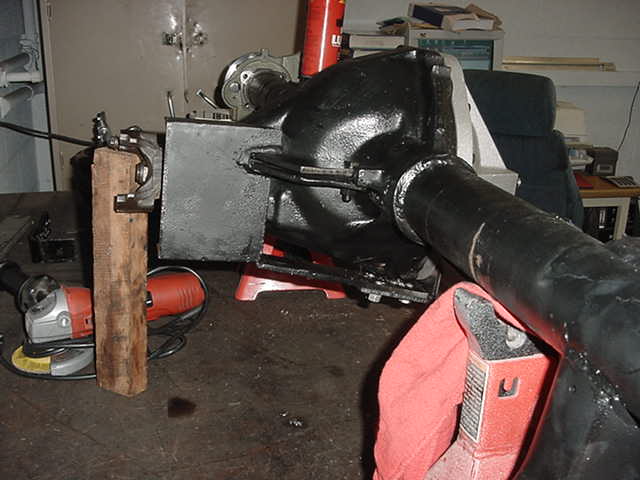

                    Looks real good!
                    How did you attach the "block" that appears to serve as the TA mount?
                      The TA mount is 6 inch c-channel that I milled to 5.850. I took off equal amounts on both sides. I then built two brackets: One is bolted through the housing up front, the other attaches through two cover bolts on the rear. The back part of the rear bracket is removable so that the cover can be taken off easily. It seems like its gonna be pretty strong. Its hard to see in the pic, but here it is:
                        Is that 3/8" c-channel?
                          Yup, the wall thickness is 3/8".
