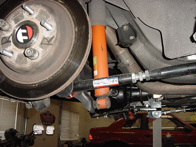

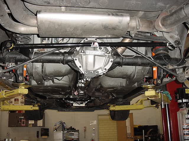

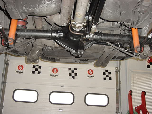

    I drove it last night and just got done doing some more tweaking. All I have left is to put in the rear sway bar. Check it out....it fit like a glove

            Nice work! It looks like you had to fab up the torque arm mount from scratch - think that is going to hold up under a hard launch?
              That thing was built to take a pretty hard hit. The 6" c channel is bolted through the housing up top (where you cant see in the pic) and it has an extension that goes to the rear cover where its bolted there too. Its all fabbed out of 3/8" steel plate. It also has a ubolt that is wrapped around the the snout of the diff. Lets put it this way, if it breaks, its taking the whole the pumpkin housing with it.

                    Sure looks nice! Was there any whinning at all under load? I hear that whole backlash business could be very tricky if not done properly. I take it you hit the nail right on the head with this one!
                      Yea, its sounds pretty good. I didnt have the preload correct on the pinion and it was singing a bit, but I just tightened it down and it sounds pretty good now.
