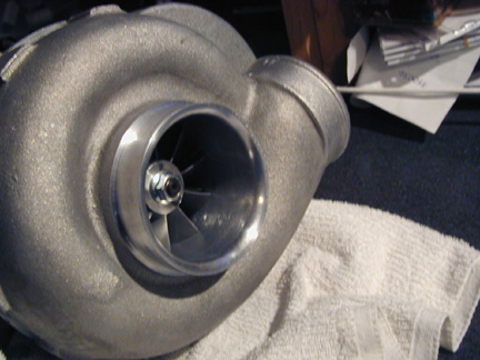

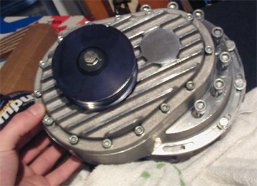

    I have a Powerdyne BD-550 centrifugal supercharger that I need to get rid of cheap. Has about 5,000 miles on it, and is barely used. My friend had a shop put it on his 2000? Nissan Pathfinder, but they could not tune the computer properly, and it was idleing horribly. He decided to go back to stock, and pulled it all out. All I have is the Supercharger Head unit, and a 12:1 FMU. The supercharger was from the 96-98 Mustang GT kit (2valve). I cleaned it up a little bit, polished the intake, and it has been sitting around for like 6months collecting dust.
    I called Powerdyne support, and they offered no real help at all. All they said was it wouldn't fit.... I was going to fabricate some brackets, and custom fit it, but have not had the time. Let me know if you are interested, otherwise it is going up on ebay. I have to pay off some parts I ordered on my credit card, so I will take a loss and let it go for $350 shipped, including the FMU.
    Oh, I think it has the 6.5psi pulley on it.

      Front Pic

        Back pic
