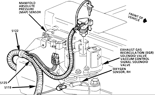

    I cannot, for the life of me, figure out how to remove the electrical connector on the EGR valve assembly...
    Picture attached of the beast...
    HELP!
    1995 Chevy Camaro, V6, 5-spd Manual - Looks like it just rolled off the showroom floor :-)
    Well, you first got to remove the keeper which is that plastic thingy on a srtap. That keeps it from ever rattling loose. Get that out first then you still might need to push a tab back, but it will be doable.
      I figured it out... it's a Homer Simpson "DUH!" moment... just reach around to the right hand side of it and you can "push in" on the tab and release it.
